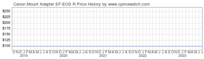

    The Canon Mount Adapter EF-EOS R launched in October 2018 at $99. Since then, it’s been…$99.
    The control ring version launched at $199, and dropped to $149 earlier this year, a $50 increase just returns it to the ‘normal’ price. But a 50% price increase on the cheapest version is a significant increase. We can speculate on the rationale for that increase, but the price increase relative to the past cost is fact, not theory. Also, who (besides you) said anything about conspiracy theories? My point was that this is a business decision.
