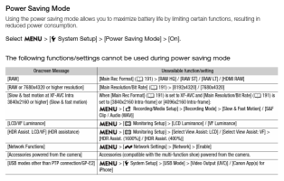

What functions are restricted when power save mode is enabled? Source: Canon Asia
An updated version of the user guide (video edition) was released the same day as the firmware.
Network Functions are mentioned. For a moment I thought > Basic Start/Stop for video via Canon Connect (but no
:slightly_frowning_face:
). It pertains to wired ethernet.
The power saving mode adds about 11-15 min of recording time in 4k. I didn't run for the full time, but the battery indicator held up during stationary shooting.

I got more than than 11-15 mins after the upgrade in battery life when in power saving mode.
I did notice that around the 30 min mark maybe a little less that the battery went to 1 bar.
But the battery life timer that is next to the battery symbol said I had 30 mins and I will say it did indeed last for 30 mins .
That allowed me to fill a 128gb cf express card and I still had 15 mins left on the timer.
So I ran it til I exhausted the battery and I did get over an hour record time shooting 4k30 xfavc.
I am gonna run some more test but for me this is a huge improvement in battery life over the earlier firmware.
So on a single LP-ENH battery I was able to record for over an hour with no issues at all.

Cheers for seeing the recording time through. I did a lazy man's test and spent all of 10 minutes., Your test was much more accurate and better than mine. I think I went to about 74 min. So this translated into over an hour. It does represent the 30% increase. Your test demonstrates the optimization we all knew could be done where the battery would show depleted in video mode and then show 2 bars if switched back to photo mode.
All things considered, its a fantastic update. :)

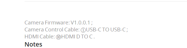

Random: The camera does not work with the DJI RS3 Pro gimbal - 1.0.3.1 & 1.0.4.1 FW tested. - Reported by a friend.
Please explain.
If you look on DJI website. They say the Ronin RS3 pro is tested/certified to work with the R5 C with FW version 1.0.0.1... he was running 1.0.2.1, didn't connect. Then 1.0.3.1, didn't connect. Then tried v1.0.4.1. He contacted their support. Basically DJI accused him of not connecting the gimbal to the correct USB-C port on the camera, except the camera only has one port, OK? ... then they said, oh, well go back to v1.0.0.1... like thats something someone would do. He sent it back. Its a beautiful gimbal, but doesn't work with later versions of FW apparently. He's not a weekend warrior and knows what he's doing. If he said it didn't work, I believe him. Here's their fine print.
Connect for the record trigger and to run power or just the record trigger?
Regarding the reported bugs with firmware 1.0.4.1:
  • I can't confirm the "pixel shift" bug when using custom modes. The files are the same size as before (both JPEG and RAW) on my model.
  • The camera also works with the DJI RS3 Pro as before and record start/stop can be triggered via the gimbal. A common problem when you can't control the camera over the USB-C port is that the cameras USB mode is set to the UVC protocol - you might want to switch it to PTP-connection. Then you should have no problems initiating recording on the gimbal
Also the power saving mode increased the estimated record time from 60mins to 76mins on a fresh battery (in 4k XF-AVC, 25p).
Ronin RS3 Pro works with 1.0.3.1 - have not tested the new firmware yet, but see no reason why it wouldn't work. Firmware on his Ronin up to date?
