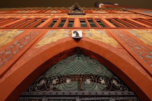

For the miniaturization effect, is it better to have a wider angle TS lens, or a 'normal'? I have a 24mm Tilt-shift, but never really mastered doing the effect. I bought it mostly for pano style frames using shift only, and only tried the tilt thing a few times. What are the tricks to getting a good mini effect?
The longer the focal length, the more exaggerated the effect will appear. Shooting from an elevated position also helps a lot. Note that the miniature effect can be reproduced pretty well in PS, there are plenty of tutorials. For me, it was something I played with and use only sparingly. My main use case for my TS-E 17 and 24 lenses is architecture, mostly shift but also sometimes tilt. For example:
"Rathaus Basel" – town hall in Basel, Switzerland
EOS 1D X, TS-E 17mm f/4L, 30 s, f/11, ISO 100
that's a wonderful image
